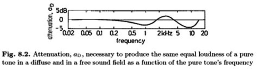

What are your thought on some facts which imply that a flat /smooth frequency /sound power response is not always ideal for a good loudspeaker.
There is the different perception of loudness of diffuse sound compared to directional sound due to the head related transfer functions.
QSZwaWQ9QXBp
But we only have one stereo mix. Therefore you potentially have to compensate differences which occur due to more or less diffuse sound compared with the amount of diffuse sound at the recording studio. This differences are most of the time greater if you have a shorter or longer listening distance and a more or less omnidirectional speakers. And there also might be an effect that room acoustic cues of the recording provide the wrong tonality due to most likely less diffuse sound in the speaker play back system.
And there are some other difficulties due to only one stereo mix. There is the dependency spl and loudness.
So you potentially also have to compensate the difference in playback spl at home vs. at the mastering studio.
There is also a difference in tonal perception from a spherical, cylindrical and flat wave front due to the HRTFs and some other potential smart to use compensation which introduce some peaks and dips.
So I think it is to strickt to dismiss every loudspeaker as not good which has some smaller like +/-2dB deviations from a flat frequency response or sound power response. It is of cause extra hard to tell if these deviations are good (for your specific case) or occur there by bad engineering.
I would like to hear your thoughts on this.
QSZwaWQ9QXBp
