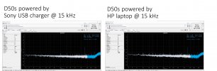

Would the better answer start with "In a properly designed power supply..."? Inconsequential of the fact that the internally generated noise energy is at least -100dB (re: MAINS voltage; excluding its own noise spectra).
So much talk about properly designed…
Look at this Topping D50s measurement with different power sources.
