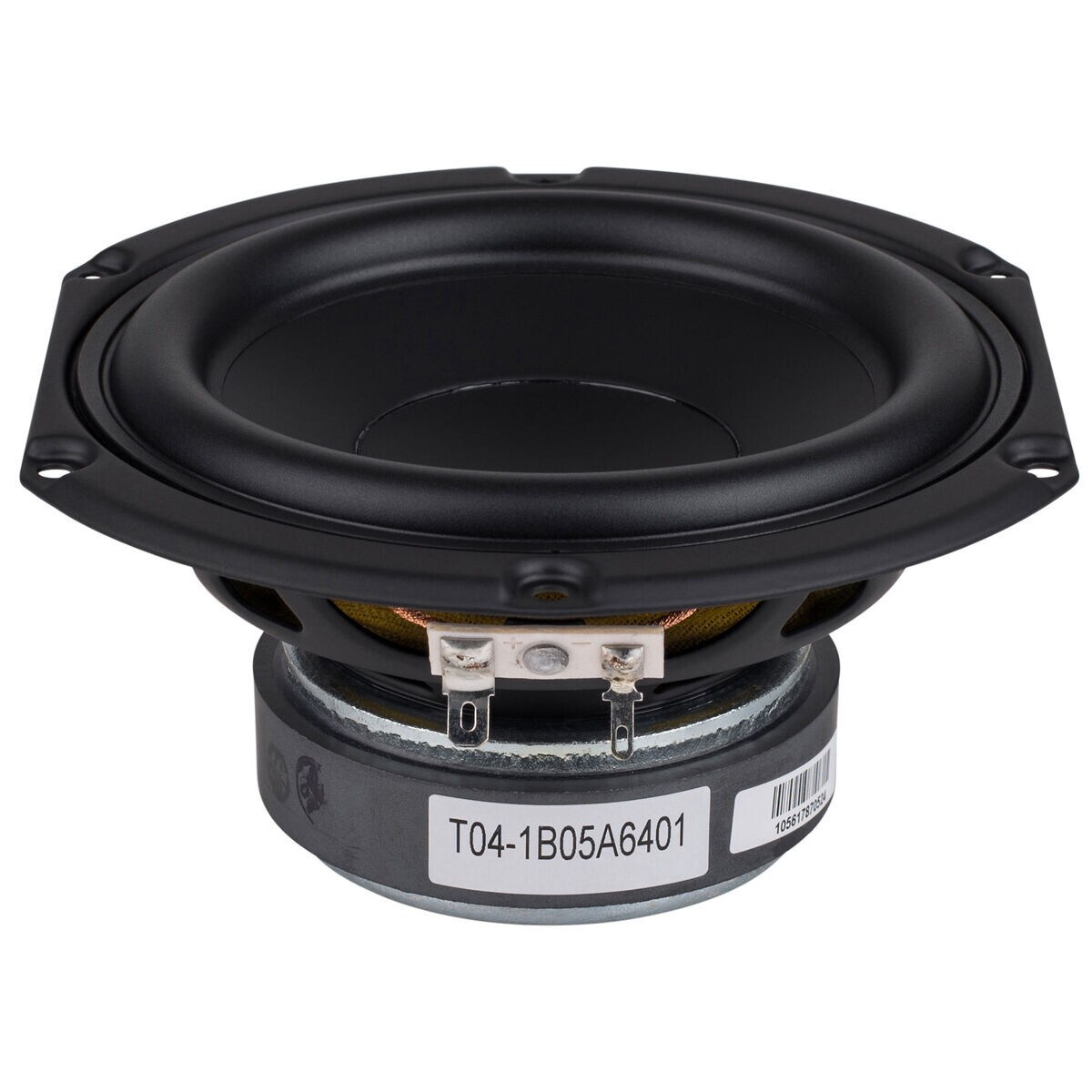

Anarchy 554 or 558 depending on whether his amp can handle 4 ohms.
Cheap but sounds good:
Needs 1500 Hz crossover, response builds in baffle step (whether you need this depends on where you will put it):

There's also Dayton nd91 / nd105 / nd140
Or TCP series, but on backorder currently
You could also try a mark audio full range driver I guess , though coming from a Logitech, he may be used to a "warm" sound with lots of bass

MTG Designs AlTi DIY uses a combination of a HiVi M5N 5.25 inch woofer and a Dayton DC25T-8 tweeter. Very economic and worth a look.

402
