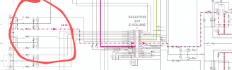

ZolaIII
Jul 28, 2019
4,196
2,476
Which?
Usually, commercial power conditioners do not have a DC Blocker inside.
RUL old one but it doesn't matter. I need to rip it open and see what I can do on this part particularly,
1591422660537~2.pngboth regarding grounding and isolation (which won't happen soon).
