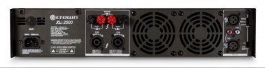

I ordered two 07 Max and waiting for delivery. Here is part of their web page and description of the amp. Did anybody try to connect that way: Mono Max Output Power(switch mono mode):600W/ 2Ω(48V/12A)
(R+ connect to speaker +, L+ connect to speaker -)
L+ to speaker - (??)
I don’t think that’s unusual when bridging an amp?
