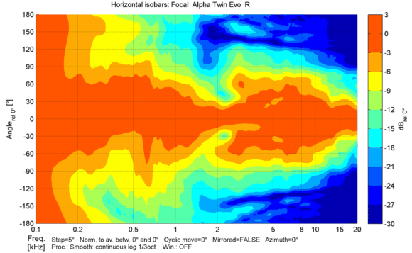

SoundAndRecording today posted the spin for Focal Alpha Twin Evo:
Which retails for US$650/each.
It has dual 6.5" woofers.
I appreciate that SoundAndRecording started posting the CEA-2034-A graph along with their normal graphs:
The rest of their graphs:
Discuss!

Seems pretty pointless. The normal Alpha 65 Evo is much cheaper (more than 400€/pair less), much smaller, much better horizontal directivity, flatter FR at the cost of slightly less bass extension (2Hz) and slightly lower SPL.
These horizontal 2 1/2 way designs just consistently fail to impress me and I don't know why major manufacturers try to implement that inherently inferior design over and over again.

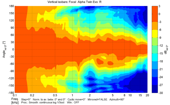

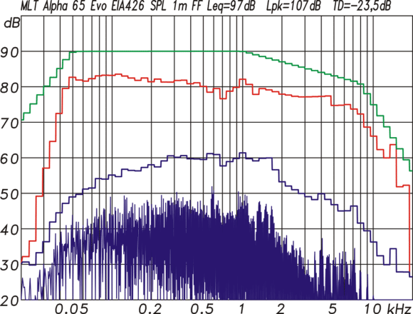

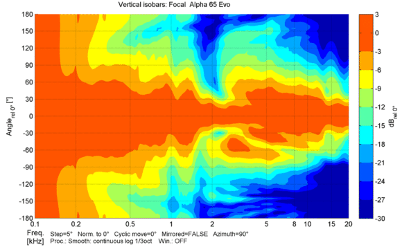

While I am not also a fan of such designs, I think a smoother vertical directivity can be an advantage at desktop or console monitoring where the vertical surface reflections are much earlier and stronger than the side walls ones, here the comparison of both:

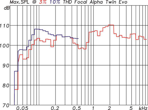

The 3-5 dB higher max SPL are rather a secondary welcome gift:
