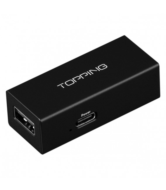

Forget about optical lines from D10S, they are only output lines (to send it to another DAC for conversion). By debugging by your self I ment determine the cause of ground loop which probably is RCA cable so start from there (try another one for which you know it's OK).
This is just for illustration purposes as its A to A.
You need one with output connector that DAC has as input and don't use patch - extensions one. That may help regarding it's performance but I am sure groundlop isn't there (EMI certainly is).

I don't believe a separate power supply helps here. It doesn't change the fact that the PC Earth is referenced to the DAC earth, and on to the amplifier earth. The earth loop still exists. You can use a USB isolator device - but this will be as expensive as a new DAC if it does the job properly.

@tonycollinet in my experience it does help (separate power source from less problematic AC/DC convertor like old mobile charger can improve SINAD couple of dB, battery couple more in some cases). Still use of short one is advised. As long as its good working normal quality RCA cable (acording to AWG with normal shielding) you are good up to 5~10 m length. Of course buy the length you really need. I won't tell anyone which one to buy. Buy a deacent known brand one with proper specs which ever is better available and cheaper where you live, don't buy fancy expensive one's (if it's not about some bizarre self propelled Estetic - Art driven desire to own "designer cables"). Buy a stage TPE coated one's if you wish.
