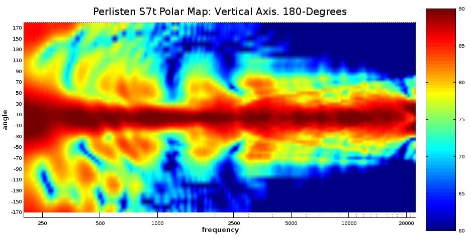

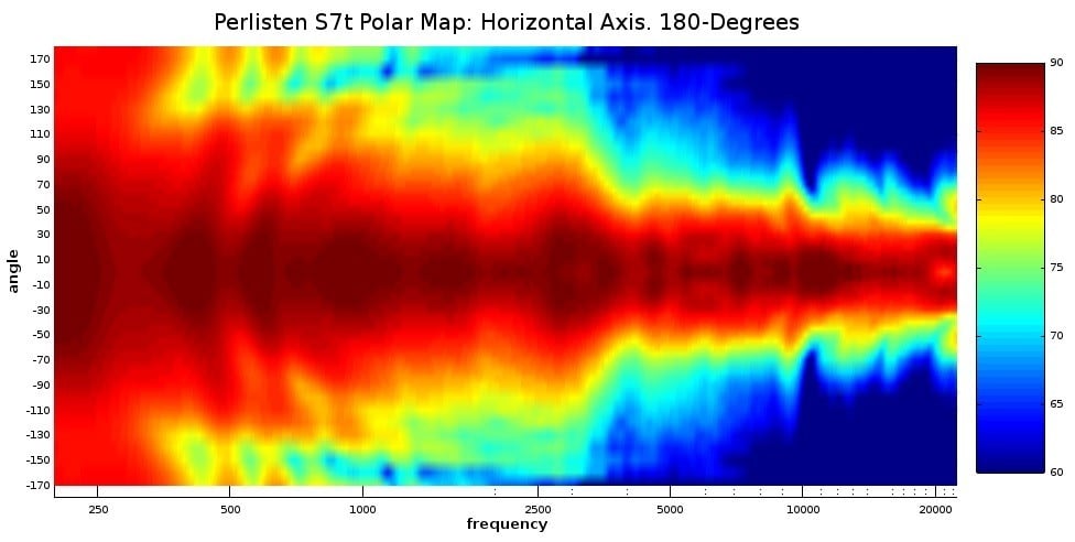

Perlisten S7t was reviewed and measured by James Larson for Audioholics.
Full Article: https://www.audioholics.com/tower-speaker-reviews/perlisten-s7t

for everyone else that didn't bother to read the full review, this is the distortion at 95 dB, which is basically below 1% for all frequencies above 100Hz.
Distortion is also significantly (5-10 dB) lower than the Revel F328Be, which is similarly priced.
Also, keep in mind that James' distortion measurements are done "free air" at 2 meters making his 95dB @ 2m = 101dB @ 1m (which is the metric Amir uses). I specifically asked James this and he verified about the measurement conditions.
Though, James states to ignore <150Hz due to room effects.
So, the comparison isn't quite apples-to-apples.
