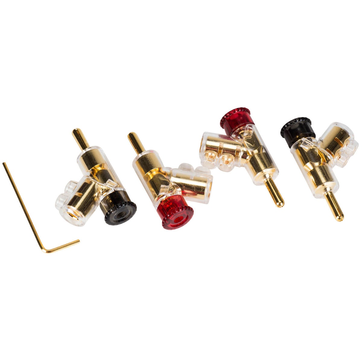

I couldn't agree more, and IMHO, especially the BFA type. You can easily tweak the gap to tighten up the fit unlike the more common "spring-loaded" versions, and also avoid having to screw down a locking collar that in my experience doesn't always guarantee a tighter fit in some banana receptacles.
I grabbed a 10 pack of these, considering these are standmount speakers, and it made for easier cable management, both into the speaker, and the back of the receiver in our TV stand that has a back panel...

I use these because the covers protect against shorting and the locking mechanism works very well.
