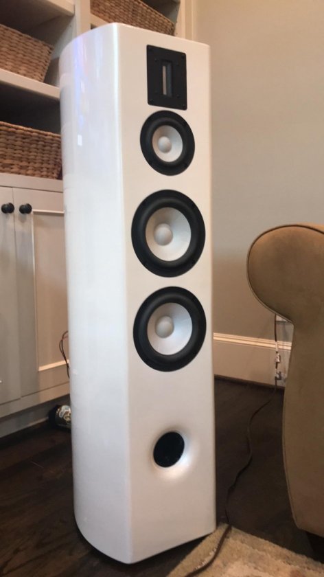

Agree, that’s what I’ve done for my speakers. They are both full kits designed by SB Accoustics. They are excellent IMO, maybe one day Amir will be able to measure them. I find my ARA Be pair to perform far better than the already excellent Buchardt Audio S400 I had before them....
Yah, I really want to see how those measure up here. They sure are made well and with superb drivers. Congrats on putting those together!
