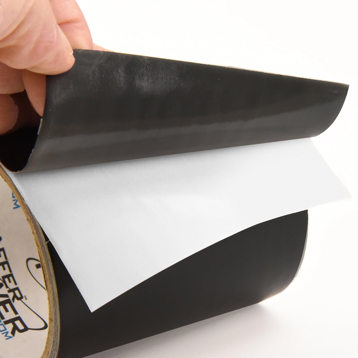

If the Pioneer were mine I would try to improve them by spending the least. The frequency response would modify it as I did with the coaxials: minimum phase PEQ + rePhase -> convolution filter. Few filters and with high Q of course!
* https://www.audiosciencereview.com/...inimum-phase-vs-linear-phase.8762/post-253826
* https://www.audiosciencereview.com/...phase-vs-linear-phase.8762/page-7#post-225351
I would open the box and add cheap dampening material.
Spend more on them does not seem logical, to listen to good recordings (music) with DR > 10 dB.

Finally, as I suppose they are placed on a table or bookcase, it would be convenient to increase the acoustic insulation with respect to the furniture. Incidentally, tilt them slightly up so that the tweeter points better to our ears, if we listen in the near field as I suppose.
