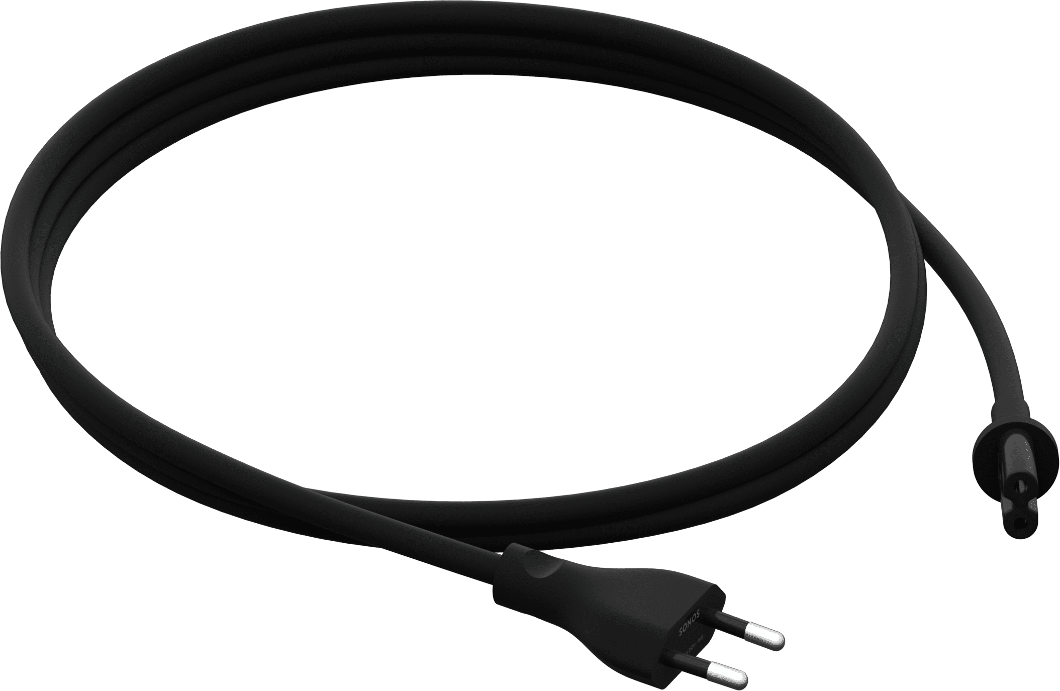

You wrote also : "The power cord, it is not proprietary, it is a stock standard IEC C7 power cable that has been around for decades. Literally anyone who has been into electronics for more than 5 minutes should know this."
It's note true... The power cord is not a stock standard IEC C7 power cables... Its termination is circular and exactly fits a circular recess in the case for aesthetic reasons and this cord is sheathed in fabric and is very flexible... And Amir's criticism was precisely to say that it was very beautiful and undoubtedly expensive... for nothing... because it was made especially for Sonos... like for example the cords for I-Mac although using a plug standard in appearance use one that has a circular cover that fits into the back of this computer for aesthetic reasons and a better fixation... Moreover, in terms of compliance with the standard... try so to change the cord of a mac mini- IEC 7 -, of your electric razor by another, for the standard shot, and you will see that it will often be necessary to take out a very sharp blade to resize the width of the plug and plan the polarizer...
What you take for errors and which serve to disqualify Amirm are not really errors - asking a question about ethernet is not an error -, and allow you to avoid facing reality measurements made by this very competent tester... diverting attention from the main thing: the performance of this device... And also the fact that Sonos preferred not to react when it could...

I did not mean to make it sound like a personal attack. I can assure you, it was not. Maybe it is a cultural or language barrier, English is my 4th language. If the reviewer feel offended, I am sure he can ask for an apology himself.
As for the power cord that you seem to fixate on, it is indeed a stock standard IEC C7, even though it is recessed, the power socket on the Sonos AMP is indeed standard IEC C8. I have the device Infront of me. They are also not expensive at all, I bough a 5 meter one at my local retailer for 5 Euro, and it fits in the Sonos AMP as expected.
In regards to the iMac example that you brought up, this is not an IEC standard cable, and it is also not meant to even be user replaceable, (which is a discussion for itself) so I am not sure why it is even an example.
In my 30+ years as an engineer, I have NEVER heard of anyone ever needing to "blade" the connector on an IEC standard cable to make it fit. That should NEVER be done. Electric razors does not commonly even use IEC C7, they commonly use IEC C1 or IEC P-C7. They look very similar, but are not. Maybe you got them mixed up?
Pic showing IEC C1 + C2
Pic showing IEC C7 + C8 and IEC P-C7 and P-C8
I don't know where you are from, or at what quality standards your country sells cables and devices, but here in Europe where I live, a standard cable is always a standard cable that works. The scenario you are describing just doesn't happen.

When we start a review the way you started it, obviously we are trying to disqualify the tester... And when we continue as you do, it becomes clearer... In short, you were wrong: Amir knows perfectly how to measure electronics and loudspeakers and his are rarely disputed...
Besides, I'm not focusing on anything: I'm just answering you. Because the means you used to disqualify Amir are a very ordinary way of bad rhetoric : you connected to ASR just for that... it seems ?
One thing: the Imac mains cord is obviously interchangeable by the user: it is an ordinary cable fitted with a plug similar to that found on high fidelity equipment... IEC C13, but like that of the Sonos it has an additional cover coming to be embedded in a knockout made in the back of the Imac...
As for the no name cables IEC C7 that can be used on a Macmini or with this sonos ... they are often not exactly the desired size... so we cut a little... for enter : especially for the Mini or for ATV or Airport express...
But Amir insisted on the luxury of the Sonos cable: clearly it is not a stock cable, but a specific model... Amir was not mistaken... he who has already tested devices equipped with the same plug...
For Sonos : 24,95 euros
For Imac : 12,48 euros
